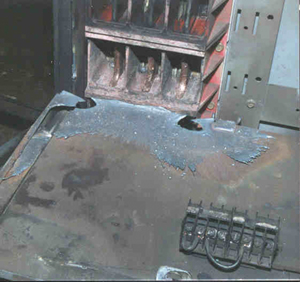

The plaintiff's attorney retained me to investigate the cause of the accident and uncover what had initiated the arcing and burn down. Clearly, some conducting material had made contact between the metal of the cabinet and the 480V bus bars. A burned screwdriver found at the scene was a likely candidate. Inspection revealed that the gap between the upturned rear edge of the horizontal separator pans and the vertical rear panel of the plug in motor control units varied from 1/16 in. to ½ in. Thus, it appeared that this gap wasn't a parameter subject to quality control in the manufacturing process.
In the product bulletin for this MCC line the manufacturer indicates that “optional bus closing plugs” should allow for complete insulation and isolation of the vertical bus duct. Photographs of the equipment show these bus closing plugs installed everywhere except for those plug-in openings into which stab connectors are to be inserted. The MCC involved in this accident had these bus closing plugs installed in all of the spare bays. However, none were installed behind active bays (Photo 2).
Just before the accident, the electrician had been sitting on a stool with the cabinet door open. He began to cut the wires, strip the insulation, and connect control power to the connector strip on the horizontal separator pan. He may have laid down the screwdriver on the pan while cutting and stripping the next wire. When he reached for the screwdriver, it rolled to the rear of the cabinet, and the shank and blade passed through the gap and made contact with one of the phase bus bars, thus creating a line-to-ground fault. The initial arcing ionized the air, causing the fault to propagate to the other two phases.

Several pages of my deposition were devoted to questions and answers regarding the optional bus closing plugs (Photo 3). I testified that given the variability in the gaps between the horizontal pan and the rear cover of the plug-in modules, these bus closing plugs should be mandatory. The warning message on the face of the bus closing plugs suggested that the design engineers didn't consider these plugs to be optional. The message reads:
“DANGER: REMOVAL EXPOSES LIVE PARTS; REMOVE ONLY TO INSTALL UNIT.”
If these plugs had been in place in this particular MCC, this accident would never have occurred.
I also pointed out that the bus closing plugs were installed in the equipment delivered to replace the damaged MCC. It appeared that the manufacturer, at least on this order, had installed the bus closing plugs in all unused positions (Photo 4 above). The installation of these plugs is an important safety consideration because if a plug-in control module is removed from the MCC, then all but the uppermost opening to the vertical buses will be protected from accidental contact with the 480V bus bars.
