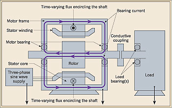

The most common underlying cause of unwanted bearing currents in sine wave-driven motors is alternating flux, which is a result of asymmetric magnetic properties of the stator or rotor core.
Fig. 1. In this sine wave powered motor, bearing currents
result from time-varying flux encircling the motor shaft.
Electric steel isn't totally homogeneous, so flux paths in the motor aren't entirely symmetrical. The asymmetrical flux through the steel results in time-varying flux lines that enclose the shaft. This can drive a current down the shaft, to the bearings, through the frame, and back again through the bearings, as shown in Fig. 1 above.
The resulting current isn't localized within the bearings. In fact, you can measure its driving voltage on motors with at least one bearing that's electrically insulated from the motor frame.
