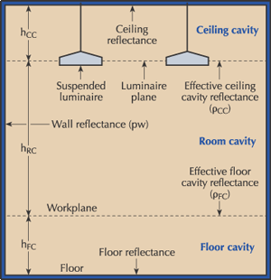

Manufacturers will supply each luminaire with its own CU table derived from a photometric test report. The effective cavity reflectance factors (CC) of the ceiling, walls, and floor are listed across the top of the table. These reflectance factors are based on the concept that a room has a series of cavities determined by the elevations of the luminaires and the workplane. And these cavities, or zones, have effective reflectances with respect to each other. The room cavity ratio (RCR) is determined by using the zonal cavity method.
In the zonal cavity method, the CU, the effects on light distribution of the luminaire mounting height, the room's size and proportions, and the height of the workplane are considered mathematically, using the following methods and formulas.
Divide the cross section of a room into three sections or cavities. The space between the ceiling and luminaire plane is the ceiling cavity. In the case of either recessed or shallow surface mounted fixtures, there is no ceiling cavity. The space between the luminaire plane and the workplane is the room cavity, and the space between the workplane and the floor is the floor cavity.
The cavity ratios (CR) for these three cavities are determined using the following formula:
CR = [5 x h x (room width + room length)] ÷ (room width x room length) where h is the CC for the ceiling cavity ratio (CCR), the CC for the room cavity ratio (RCR), and the CC for the floor cavity ratio (FCR).
Since the CU is based on the RCR, it's necessary to treat this cavity as if a ceiling surface existed at the luminaire plane and a floor surface existed at the workplane level, as shown in the Figure above. Therefore, it is necessary to convert the actual ceiling reflectance into an effective ceiling cavity reflectance, referred to as "pCC." In a similar way, the actual floor reflectance must be converted to an effective floor cavity reflectance, referred to as "pFC."
