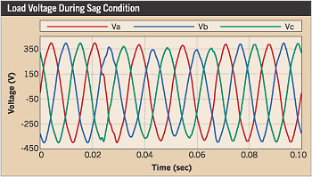

Response of motor loads to unbalanced voltage sags. Voltage sags caused by faults on the supply system are detrimental to the safety and normal operation of industrial processes. These short voltage variations can cause sensitive loads and controllers to trip offline, affecting the entire production process. Voltage sags can even affect conventional induction motors. Fig. 1A on page 24 shows the response of a motor load during a voltage sag condition caused by a single line-to-ground fault on the supply system. In Fig. 1B, note the severe unbalance in the current caused by the unbalanced voltages during the sag condition. This can cause negative sequence relays to operate. In some cases the high currents following the sag can trip motors on overcurrent.
