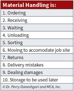

Material handling is much more than simply ordering and receiving. Material handling, by definition, based on a study done by MCA, Inc. for Electri International, formerly Electri21, can be as much as 40% of an electrician’s time. Recognizing all the items involved in material handling that impact your labor productivity and your project’s profitability is shown in Table. This includes:
  • Ordering (whether it’s a call to your inside sales, done by the project team, or the prefab shop, done online, with a material request form). Are you doing it daily or weekly?
  • Receiving (at the job site, at the warehouse, in the office, etc.). Planning this is a large portion of Step 3 of the PoP.
  • Waiting (for someone to answer your call or the delivery truck to come).
  • Unloading (think of how many people it takes to unload the truck and what happens if you have to pull your crew off to do this).
  • Sorting (through the delivery that likely has many items mixed in boxes or individual boxes needing to be opened to confirm everything is there).
  • Moving to accommodate job site (you have your location on the job site where you’re storing things, but you have to move to the installation location, or move your laydown area when the job progresses).
  • Returns (MCA, Inc.’s research shows that the main reason for returns is overordering, which can be caused by finding/moving material on the job site).
  • Delivery mistakes (no one’s perfect).
  • Dealing with damages (items ordered early that get shuffled or actual issues with damage from the manufacturer, vendor, or distributor).
  • Storing material that will be used later (linked to moving to accommodate the job site, early ordering can cause issues like noted above, such frequent movement or issues with the elements).
