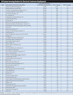

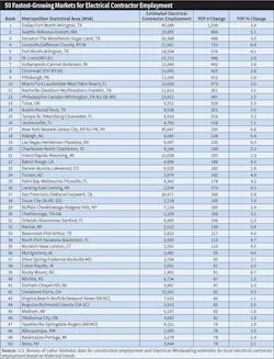

    Another good indicator for some insight into the health of the construction market in local market areas is the contractor employment data available from the U.S. Bureau of Labor Statistics (BLS), as shown in Table 2. BLS also provides data on job openings at contractor firms. Even though employment at electrical contracting firms is at near-record levels, contractors are still looking for more employees. According to EC&M estimates using the JOLTS data from the U.S. Bureau of Labor Statistics, electrical contractors had an estimated 32,400 openings for electricians and 46,800 total job openings nationally (Fig. 2).

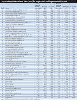

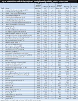

    Small rebound in residential
    Unless electrical contractors get involved with home construction in some of the hottest housing markets in the country, which tend to be in the Sunbelt and Intermountain states, the residential market may be one of slower business segments in 2024. It probably won’t get much better  soon, unless mortgage rates drop to more tolerable levels for first-time homebuyers. Although the National Association of Home Builder (NAHB) expects single-family housing starts to increase 4.6% in 2024 to 946,000 permits after a cumulative decline of 21.2% over the past two years, the recovery is likely to be quite slow in all but the most robust housing markets (Fig. 3). These markets include Houston, Dallas, Atlanta, Phoenix, Charlotte, Orlando, Austin, Nashville, Tampa, and Jacksonville — the nation’s Top 10 housing markets through September 2023 when measured by single-family building permits. Together, these metropolitan areas combined for 102,562 single-family permits (26% of all permits pulled by builders nationwide).
    NAHB believes multi-family permits are headed for their second annual double-digit decline in 2024, with a 12.3% drop to 413,000 permits. Through Sept. 2023, the New York metropolitan topped all other markets with 21,415 permits for buildings with five or more units, followed by Dallas, Austin, Houston, Phoenix, Los Angeles, Miami, Atlanta, Washington, D.C., and Nashville (Table 3). Multi-family permits tend to be consolidated in a handful of metropolitan areas, and that was the case again in 2023 — these 10 markets and their 138,750 permits accounted for 35% of all multi-family permits with five units or more through September 2023.
