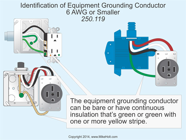

Fig. 1. So that others can identify your EGCs that are not bare, use conductors with a continuous green outer finish.
So others can identify your EGCs that aren’t bare, use conductors with a continuous green outer finish. Alternatively, this outer finish can be green with one or more yellow stripes [250.119]. Except for three special cases, you can’t use such conductors as ungrounded or neutral conductors (Fig. 1.)
The three special cases where green insulation can be used for an ungrounded conductor are:
1) Power-limited, Class 2 or Class 3 cables, power-limited fire alarm cables, or communications cables containing circuits operating at less than 50V [250.20(A) and 250.112(I)].
2) Flexible cords without an EGC (the outer jacket of the cord can be green).
3) Ungrounded signal conductors for traffic signal control and traffic signal indicating heads. The circuit must still include an EGC and if it’s of the wire type, it must be bare or green with one or more yellow stripes.
Prior to the 2014 NEC, the first special case was the only one, and it was the Exception to 250.119. Now it’s Exception No. 1, followed by Exception No. 2 and Exception No. 3.
Exception No. 2 (flexible cords) seems reasonable, as a 2-conductor cord isn’t an EGC, even if it’s green.
The traffic signal industry wanted this new Exception No. 3. Green isn’t an EGC for traffic signals; it’s the signaling conductor that controls the green traffic light.
