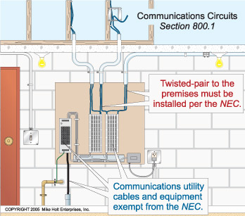

Where we get twisted. The telco typically provides the twisted-pair cable to a terminal board at the structure. This terminal board is the network interface device (NID). Art. 800 addresses twisted-pair wiring from the NID to the premises (Fig. 1). We find this kind of wiring in such central station systems as fire and burglar alarm, telephone, and telegraph.
A primary protector is a device that protects installers and occupants from electric shock. You need a listed primary protector for each incoming communications circuit [800.90(A)]. The point of entrance is where the cable enters the structure or grounded raceway. Install the primary protector as close as practicable to the point of entrance [800.90(B)] to reduce differences in potential between communications circuits and other metallic systems and objects. Those differences create personnel hazards and can lead to catastrophic failures — especially when lightning is present.
If you're installing phone cable, ground the metallic sheath (or interrupt it by an insulating joint) as close as practicable to the point of entrance [800.100]. This rule applies to other types of cable covered by Arts. 810, 820, and 830.
