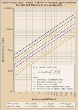

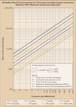

Fig. 1. Using a chart like this is a quick way to confirm cable suitability.

Figure 1 is taken from ICEA P-32-382 for maximum allowable short circuit currents for copper conductors insulated with 90°C rated thermoset insulation. Also note that the cycle time is for a system operating at 60 Hz. The formula is the best way to confirm cable suitability, but if the conductors match the parameters of a chart, it can be useful to determine if the conductor is close to its limit or obviously in a safe zone.
