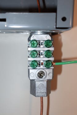

Method 2 — terminal bars
Terminal bars are often provided by equipment manufacturers to allow the connection of multiple conductors at one convenient location. Panelboards are an example where an equipment grounding bus bar is provided in the enclosure and is bonded to the enclosure. Once again, pay particular attention to instructions for installation. Unless otherwise noted in the instructions, only one conductor per terminal is allowed, and torque requirements apply (Photo 2).

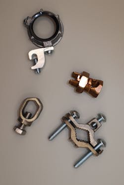

Method 3 — pressure connectors listed as grounding and bonding
This option encompasses several distinct types of connectors. These are specifically listed for grounding and bonding applications and cannot be used in other applications unless specified. When observing the label( such as UL) the words “grounding and bonding” appear adjacent to the label. Ground clamps are identified for specified size ground rod and conductor sizes. This category also includes irreversible crimp connectors that are installed with hydraulic crimping tools (Photos 3a, b, and c).

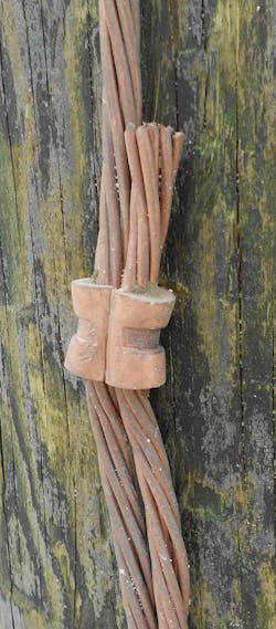

Method 4 — exothermic welding
Exothermic welding is a chemical process that fuses conductor material to form a molecular bond. This process is permanent, and the weld is not subject to corrosion. Exothermic welding is often used for the connection of stranded copper conductors to rebar. The general rule is grounding electrode conductors must be continuous in length. However, exothermic is one method permitted to splice grounding electrode conductors.
