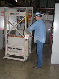

It’s no fun seeing a circuit breaker hit the floor. If no cable mechanism is available, a hydraulic lift or mechanical lift platform can help you prevent this from happening. As Photo 4a and Photo 4b show, many medium-voltage manufacturers supply such a lift to install and remove their equipment. The equipment is de-energized, and the technician is wearing the correct PPE for this task.
