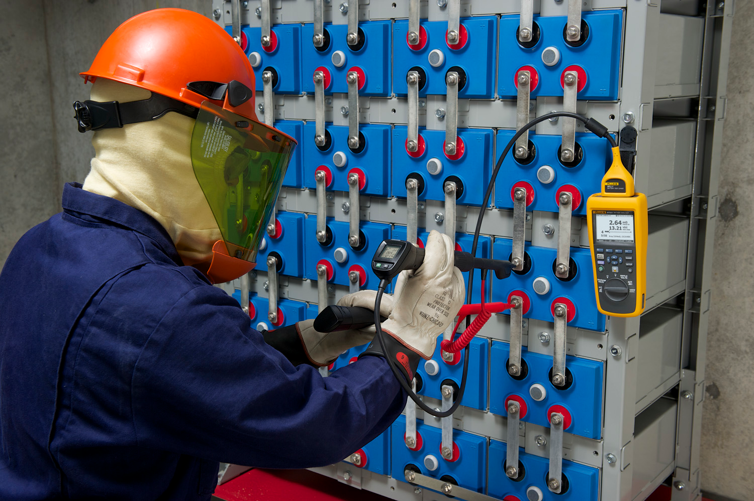

Photo 1. Direct access makes taking voltage, resistance, and temperature measurements on storage batteries easier.

Storage batteries are usually just rechargeable lead-acid or nickel-cadmium batteries without electronic controls. You can generally test these batteries directly (Photo 1).

How to test traditional storage batteries
Batteries need the appropriate voltage and current inputs. A voltage that’s too low yields a low state of charge. In lead-acid batteries, a low state of charge leads to sulfation on the internal lead plates, which reduces the battery’s output, decreases its life, and increases maintenance costs.
Test the battery’s state of charge by using a digital multimeter (DMM) to verify voltage and current. If the battery shows a low open-circuit voltage (Voc), you need to charge the battery. (Note: Consistently using a battery’s full capacity will reduce its life.)
Rechargeable lead-acid or nickel-cadmium batteries in large-scale battery systems are generally accessible enough for you to test them directly. In the interest of safety, use a meter rated for a higher voltage than you expect to measure. The procedure is straightforward:
  1. Set your meter for a voltage that’s higher than you will measure.
  2. Put the red probe on the positive (+) terminal of the battery.
  3. Touch the black probe to the negative (-) terminal of the battery.
  4. Read the meter display.
A good DMM will give you a negative reading if you’ve reversed the probes. Checking the polarity is important, since connecting a battery in reverse polarity to your equipment can cause significant damage and/or injury.
