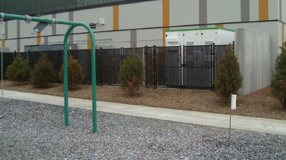

There are several ways ESSs can be utilized. Battery energy storage systems (BESSs) can be operated in a grid-tied mode or as part of a microgrid to provide power during grid failure. The electrical design and associated components will change based on the assets utilized, code requirements, interconnection to the grid, and distribution methodology.
In a grid-tied operation, the storage system is programmed to charge and discharge at various times to help with load shedding and demand response. Typically, the system will discharge the storage system during times of high demand or when on-site production is low to help reduce the energy usage and cost of the facility. Even though this sounds like a simplistic concept, it is a complex technology and feat as demand, production, and storage are all monitored and controlled. The controller is constantly trying to optimize its decisions — charge, discharge, or do nothing — aiming to maximize economic benefits based on the available energy assets. This is one of the most challenging aspects of installing an ESS.
In contrast, the ESS could be incorporated into a microgrid. In a microgrid design, the storage system would act as a buffer for one or more on-site power generating devices (e.g., traditional generator, fuel cell, solar PV, wind turbine, CHP, etc.) and interact with the traditional utility source, helping the microgrid controller to balance power production and demand more effectively. The microgrid system is significantly more complex as the system constantly works to balance all resources and demands on the system; however, it can also provide a very high level of resiliency that could allow operation without utility power for long durations of time.

Careful consideration of the electrical distribution system should be taken when implementing an ESS to maximize the effectiveness of generation and storage. A connection on the main switchgear creates a cohesive system with the most flexibility. However, this may not be the optimal solution for an existing building. Existing electrical services require tailored solutions to meet the needs of a given building.
