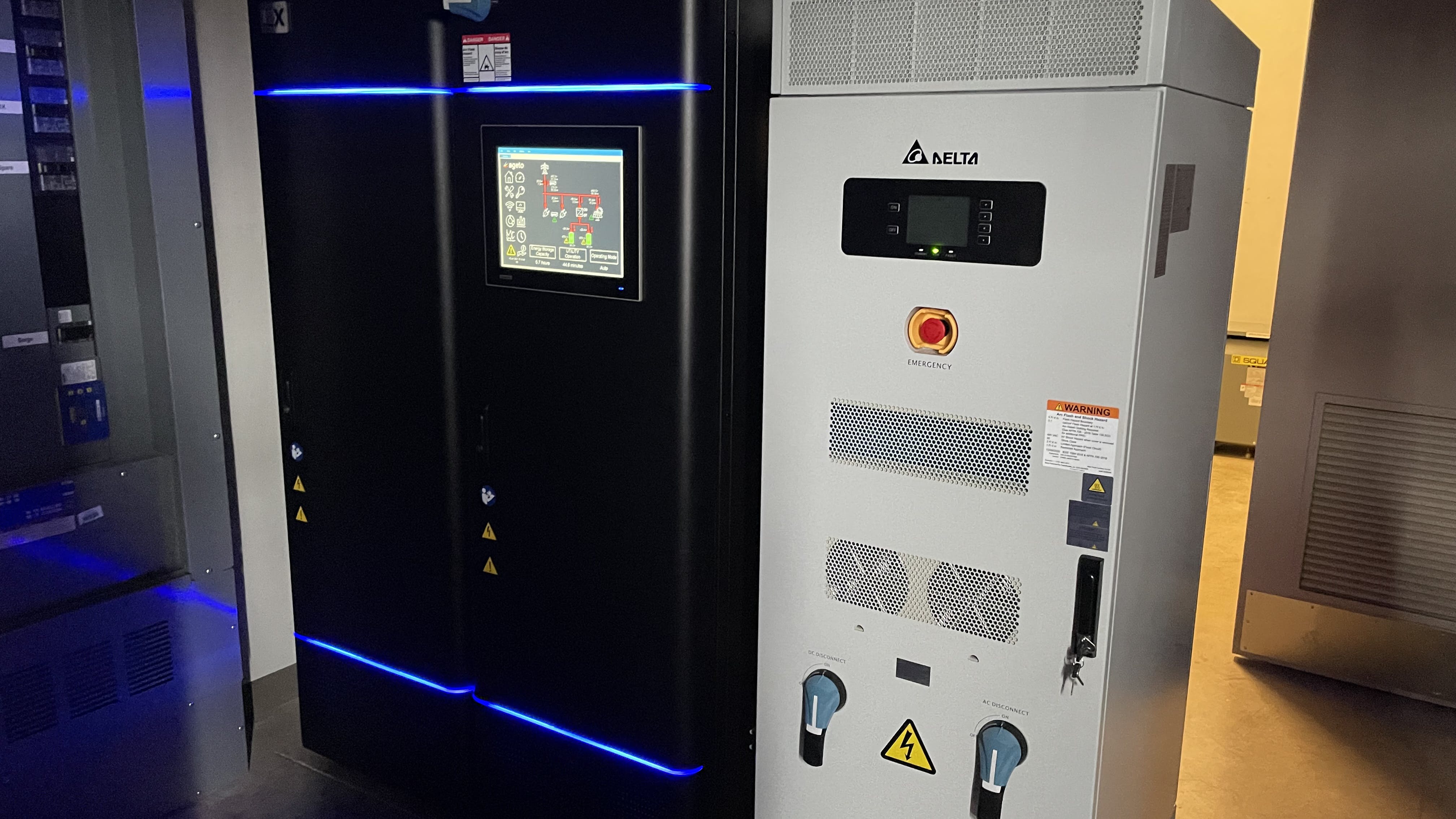

Microgrids can be as small as a single building or as large as a whole community (Fig. 1). Microgrids are distinguishable from solely solar-plus-storage systems in that the equipment must have the ability to isolate (i.e., islanding) from the grid (if grid-tied) and manage the power quality (voltage and frequency control), which is usually the grid’s responsibility.

There are various distinct usages of energy storage, each with its benefits, that must be considered and prioritized for any system. It should be noted that since microgrids include energy storage, they also have these use cases, but microgrids go further (Fig. 2).
