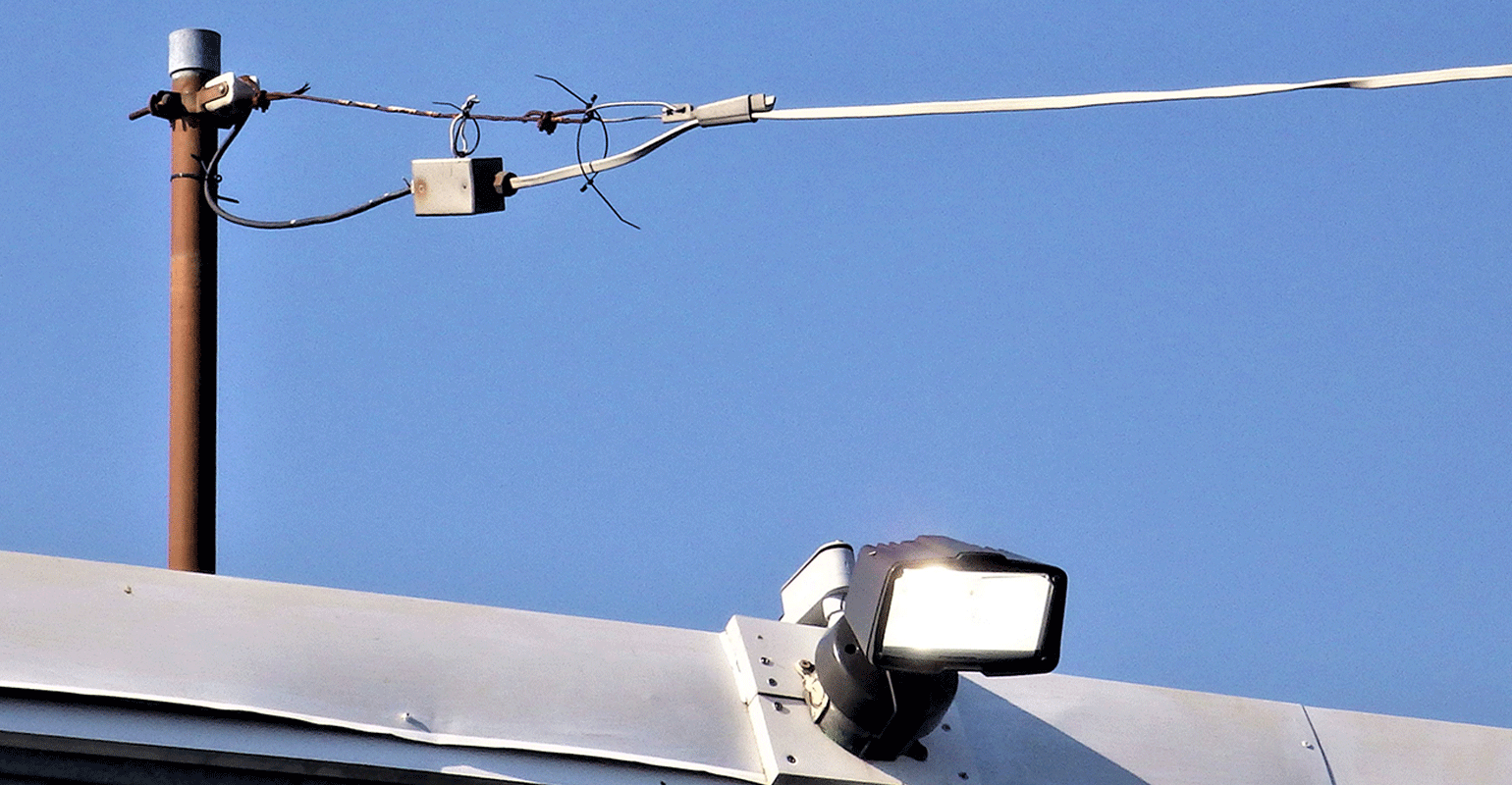

Sky-High UF Cable Violation
I spotted this mess while grabbing a lobster roll sandwich at a local eating establishment. The lobster roll was delicious, but seeing this shoddy electrical work left me with a bad taste in my mouth. Section 340.12(11) does not permit UF cable to be used as overhead cable unless installed as a messenger-supported wiring installation. There is no messenger supporting this UF cable. The support fitting is attached directly to the non-metallic cable jacket. You can’t see it from this angle, but this was a very long overhead span of cable with a huge sag in the middle. It stretched across the entire parking lot. This must be putting a large amount of tension and stress on the jacket of this cable at the points where the support fittings are installed at each end of the span. The non-metallic jacket is not designed to handle this kind of pulling stress and could eventually tear. Another problem I see is the use of a cable tie and a twisted single conductor as the supporting means for the junction box. I see no methods in Secs. 314.23(A) through (H) that would indicate that this box is properly supported.
