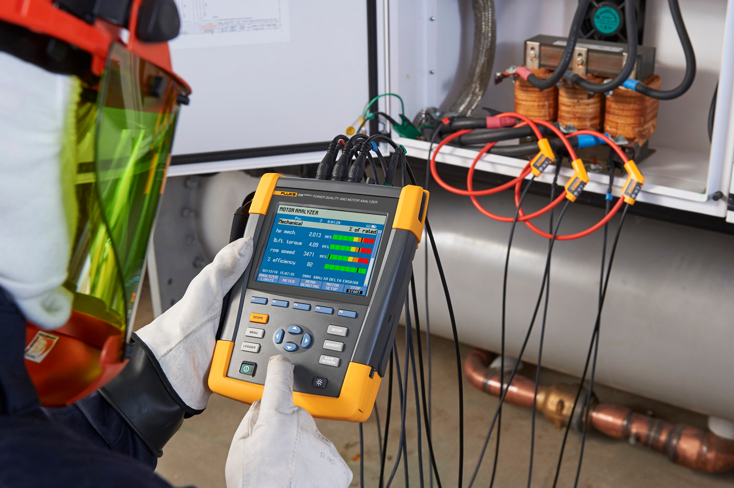

Maintenance teams should consider different categories of components when troubleshooting motor problems.
Motor and drive system technology continues to advance throughout the industry. Oftentimes, this increased complexity presents a challenge to the teams who are making sure the equipment runs at peak performance. Even then, some motor failures result from mechanical failures or even problems introduced at installation. Thus, maintenance teams need to take different categories of components into consideration when troubleshooting motor problems.
Understanding the common reasons for motor failure and knowing how to troubleshoot and repair these systems can prevent costly downtime and improve operational efficiency. The following are common reasons motors fail.

Tool to measure and diagnose: Power quality and motor analyzer, monitoring devices
