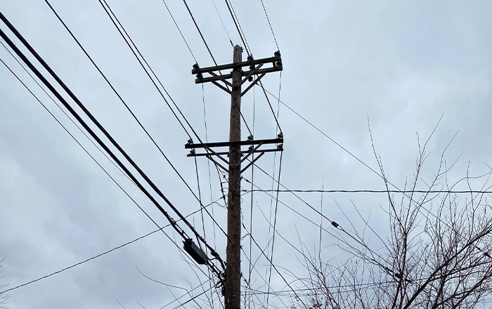

On Nov. 4, 2020, a two-person crew departed their out-of-state place of business en route to a large Kentucky metro area with the task of surveying power lines to develop future engineering plans. The job site was a residential area with homes located on each side of a two-lane highway (Photo 1).
Due to the placement of the utility poles and their proximity to the highway, the job required the duo to work in the front yards of private residences. Most of the overhead wires in this area run parallel with the roadway and cross over the highway at several points with smaller wires branching off to other parts of the area.
On this unseasonably warm November day — 68°F, 39% humidity, 8 mph winds, and no precipitation — the employees worked their way from utility pole to utility pole, collecting data such as pole height, distance between poles, and each pole’s proximity to the highway. The data they collected would later be used to develop engineering plans for the installation of fiber-optic cable.
