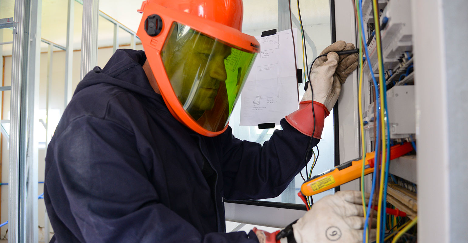

Sixteen requirements
You’ll find 16 requirements enumerated in Sec. 130.7(C). There’s extensive detail in these requirements, but here are some highlights.
The first requirement states you must wear PPE per Sec. 130.4 if working within the restricted approach boundary. But if working within the arc flash boundary, you must wear PPE per Sec. 130.5. The second one says the PPE must cover all of your ignitable clothing while allowing for movement and visibility.
The next six address requirements for specific body zones (e.g., eyes, hearing, hand, foot, etc.). The ninth requirement is particularly critical, as it explains the factors involved in correctly selecting protective clothing. The main thrust is protective clothing must fit properly and provide the rated protection.
New with this 2015 edition are subsections (A) and (B) under 130.7(C)(15): Selection of Personal Protective Equipment When Required for Various Tasks. These cover AC equipment and DC equipment, respectively. The difference is which Sec. 130.5 tables they refer to. The Informational Notes that go with these are longer than the requirements themselves but worth the read.

Getting PPE right
Three important principles will help you get PPE right:
(1) PPE is not intended to make up for poor safety practices. The role of PPE is to add an additional layer of defense against hazards you may encounter when working on or near electrical equipment.
(2) It’s not about what PPE you “have to” use, but about what PPE will help protect you against the hazards you identify.
(3) PPE can’t protect you against hazards it’s not rated for. Be diligent in identifying the hazards.
