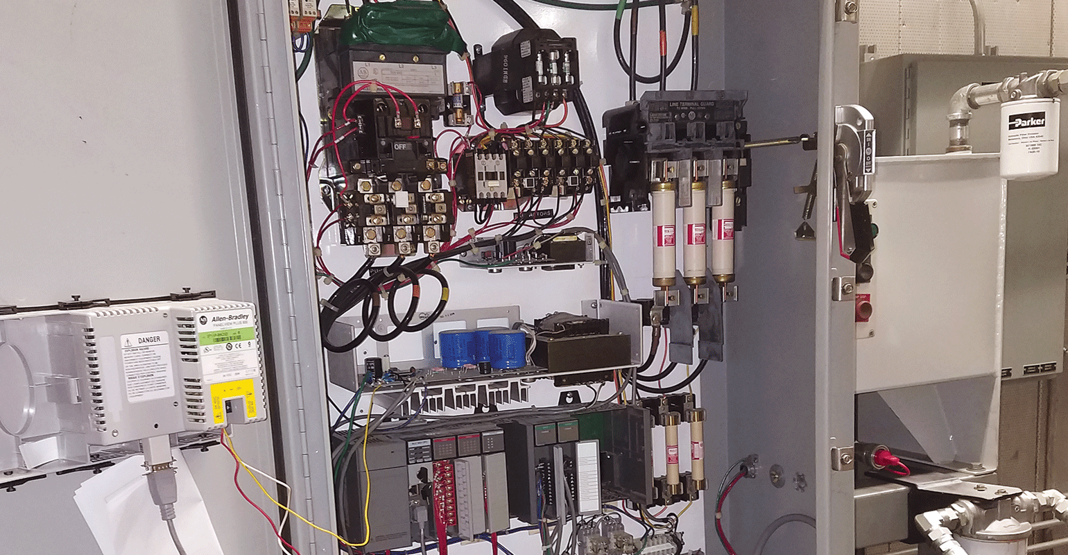

I can’t count the times that I have shadowed a worker who only works on control circuits and PLCs and discover they are regularly working on these systems in an enclosure that also has energized 480VAC equipment. It is true that they are only working on systems rated less than 50V, but they are being exposed to serious shock and arc flash hazards due to the other circuits that are energized and exposed inside the same enclosure. These employees certainly need electrical safety training to understand and recognize these circumstances and become knowledgeable of methods to ensure they remain safe while performing these tasks.
