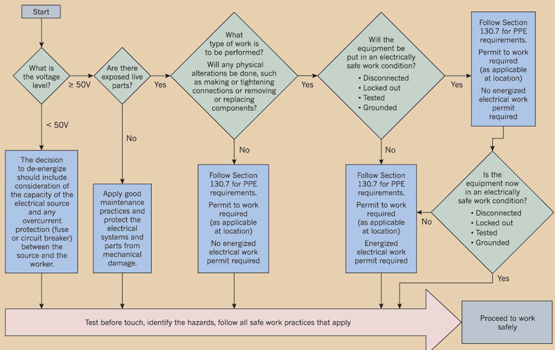

(Click here to see a PDF version of the Energized Electrical Work Permit Flow Chart)
Although it’s not split into two parts, Art. 130 logically can be. The second part [130.7] provides the requirements for personal protective equipment (PPE) and other protective equipment. The first part [130.1 through 130.6, plus 130.8, 9, and 10] provides the requirements for such things as work permits, approach boundaries, and precautions for personnel activities. This first part is what we’ll cover here.

You don’t perform energized work simply because your boss wants you to, it’s quicker, or you “know what you’re doing.” You can perform energized work only if one (or more) of three conditions applies [130.2(A)]:
  1. The employer can demonstrate that de-energizing introduces additional hazards or increased risk.
  2. The employer can demonstrate it’s infeasible to perform the work in a de-energized state due to equipment design or operational limitations.
  3. The circuits operate at less than 50V. This is contingent upon the capacity of the source and any overcurrent protection between the source and the worker; there must be a determination that there will be no increased exposure to electrical burns or explosion due to electric arcs.
The Informational Notes below these conditions provide examples to help illustrate what’s meant.

Energized electrical work permit
A qualified person doesn’t need an electrical work permit to do any of the following [130.2(B)(3)]:
  • Perform tests and/or measurements.
  • Conduct thermography.
  • Enter/exit area with energized equipment, if not performing electrical work in that area and not crossing the restricted approach boundary.
  • Conduct general housekeeping and/or miscellaneous non-electrical tasks (and not crossing the restricted approach boundary).
Most people view a work permit as something that gives them permission to do the work. Instead, think of a work permit in the opposite way. You aren’t filling out the permit to get permission; you are filling it to give permission.
With this perspective, you will look for dangers rather than see what you can get by with. Someone else may sign the official approval, but you are the one who will pay the real price if something happens. Put yourself in charge of ensuring the conditions of that permit are properly met.
An electrical work permit has, at a minimum, the eight elements enumerated in 130.2(B)(2)(1) through (8). Consider number 7, which is “Evidence of completion of a job briefing, including a discussion of any job-specific hazards.” If you weren’t in charge of the permit (traditional viewpoint), you might seek some quick “check the box” way of satisfying this requirement so you can get on with the job.
But since you are in charge of the permit, that’s not what you want. Is that briefing sufficient if it’s just a quick summary with a sign-off sheet? No, you want to understand the job and its hazards. You want to be able to not only outline the major steps, but also identify how to protect against every known hazard any of those steps might bring.
If you take ownership of each element of that permit, are you going to have a happy boss or an unhappy boss? Let’s see. You are taking personal responsibility to ensure something extremely bad doesn’t happen. What competent boss would not be thrilled with this?
If you view the permit as an obstacle, then your boss is tasked with trying to make sure you comply. That’s just more work for your boss, and it leaves you at a higher level of risk.
