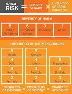

Assessing the risks
Once you have identified each potential source of electrical injury in a given work space, you’re ready to move on to assessing the risks for those hazards. “Risk” refers to a combination of ideas — the severity of an injury and the likelihood of that injury occurring. Informative Annex F of the NFPA 70E standard describes a procedure for breaking down this concept into smaller parts. Start by ranking the severity of the potential injury into one of these categories:
• Fatal or life-altering injury, permanently preventing a return to work.
• Severe injury, requiring hospitalization.
• Reversible harm, requiring professional medical attention.
• Minor injuries, requiring first aid only.
Then, for each task or procedure that could expose an employee to the hazard, rank the likelihood of an injury’s occurrence, using these parameters:
• How often will a worker be exposed — once an hour, once a day, once a month, or once a year?
• When a worker is exposed, how likely is it that the exposure will actually result in a harmful event?
• If a harmful event occurs, how likely is it that the worker will be able to limit or avoid injury?
Fig. 1. Determine the total risk for a given task by combining the severity of an injury with the likelihood of the injury occurring.
Combining the severity of a potential injury with the likelihood of the injury occurring will give you an estimate of the total risk for a given task (Fig. 1).
For example, a given piece of equipment may use enough power that a failure would cause extensive burns to an exposed worker. That’s fairly severe. But workers may only need to access that equipment once a year for maintenance, and the design of the equipment may provide a simple and reliable system to ensure that the equipment is powered down before access is possible. In this case, the probability of a worker being harmed is relatively low, so the overall risk is not as high as it could have been.
Another piece of equipment may offer only a minor shock hazard — an injury likely to require only first aid. However, the source of that hazard may be an exposed and unmarked conductor, which offers no indication of its power state, and is located close enough to a workstation that a worker could accidentally contact it very easily. Although the hazard itself is not severe, the overall risk is very high because an injury is practically certain to happen.
When assessing the probability of a harmful event, it’s tempting to assume that your workers are well-informed and are using the equipment correctly. This will result in inconsistent and overly optimistic assessment results, which may lead to a false sense of security. Always try to imagine the worst-case scenario, keeping “Murphy’s Law” in mind — if it can go wrong; it probably will.

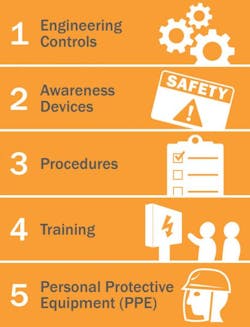

Implementing controls
Once you’ve identified hazards and assessed the risks of each, you’ll be able to see where action is needed. The steps that you take to protect workers should follow a hierarchy, so that the most effective approaches are tried first (Fig 2). Many hazards will require more than one protective action to be taken. The NFPA describes this sequence as follows:
1) Engineering controls, such as barriers and redesigned equipment, which can eliminate a hazard entirely or provide physical separation between a hazard and a worker.
2) Awareness devices, such as signs and labels, which ensure that workers and visitors are aware of a hazard before they are exposed to it.
3) Procedures, including written plans and instructions, which give workers specific guidance on performing a given task safely.
4) Training, explaining what to do, what not to do, and the reasons behind those steps, which gives workers a general background of safety that applies to similar situations.
5) Personal protective equipment (PPE), such as gloves and face shields, which offers a last line of defense for workers exposed to a hazard.
Fig. 2. The steps to limit risk should begin with engineering controls.
The steps to limit risk should always begin with engineering controls because all other approaches ultimately rely on workers not making mistakes. Mistakes are always a possibility. By implementing a control that physically separates workers from a hazard, you make the greatest possible reduction in risk.
Signs and labels offer awareness of a hazard, which helps to limit the kinds of mistakes that result from an uninformed worker doing what they consider safe. Even an untrained worker can read a label, and in a safe workplace that can be enough to prompt the necessary actions.
Specific procedures and general safety training both offer ways to prepare workers beforehand. Setting a procedure lets you and your safety team plan a safe way to do the work; general safety training empowers your workers to make safe decisions on the spot, in unexpected or new situations.
PPE is always the last step. If a dangerous situation has progressed to the point where PPE is protecting a worker, too many things have gone wrong. This isn’t to say PPE is unimportant: Where needed, it’s essential. But never rely on PPE to protect workers unless all other possible controls are in place.
