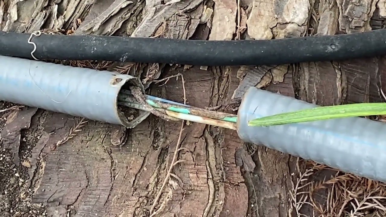

| | | | | | Russ LeBlanc comes across some partially buried and broken LFMC. This installation will need to be replaced in accordance with Sec. 350.2. In addition, it’s unclear if the conduit is marked as suitable for direct burial. There is a potential violation there. What do you think about the conduit? Is it suitable for direct burial? |
