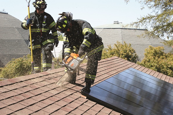

Rapid shutdown requirements were first introduced in the 2014 Edition of the National Electrical Code (NEC). The rule, as outlined in Sec. 690.12, calls for the string voltage on roof top solar photovoltaic (PV) array conductors to be reduced to less than 30VDC within 30 sec from system shutdown. Only conductors more than 5 ft in length inside a building or located more than 10 ft from an array are affected. It also requires that equipment performing the rapid shutdown must be listed and labeled.

The goal of this Code rule is to decrease the risk to emergency responders, particularly fire fighters when they work on a fire at a building with a PV system. Austin noted there are a variety of products that can address this problem. They include:
