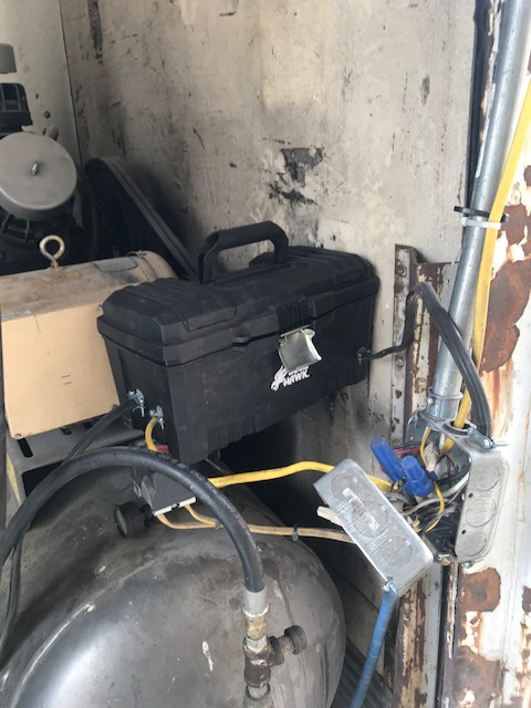

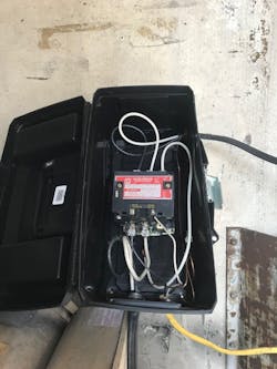

Creative Compressor Repairs
Thanks go out to EC&M reader Michael Noll for sharing these interesting photos with us. It appears the original controller for this air compressor failed, and a new controller was jury rigged by placing it in a toolbox! While I give this installer credit for creativity, I doubt this is a Code-compliant installation. The toolbox enclosure for this motor controller certainly was not selected using Table 110.28. Toolboxes are not wiring methods recognized as suitable as specified in Sec. 110.8. Using the white wires as ungrounded conductors is permitted in cable assemblies, but Sec. 200.7(C)(1) requires reidentification of the white wires by using marking tape, paint, or other effective means at terminations and other locations where the conductors are visible to indicate their use as ungrounded conductors. The lack of support for the NM cables violates Sec. 334.30. The improperly secured metal extension ring violates Sec. 314.23(A). The lack of a cover for the metal boxes violates Sec. 314.25. The number of conductors in the metal box seems questionable as to whether it complies with the fill requirements of Sec. 314.16. Lastly, securing NM cable to the EMT violates Sec. 300.11(C).
