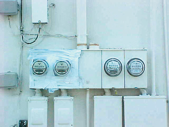

The “left arm” of this four-gang meter socket enclosure is the victim of a recent drive-by shooting. This equipment is supposed to comply with Sec. 373-2(a), but does the tape meet Code? Not a chance! In damp or wet locations, the NEC requires you to place or equip surface-type meter socket enclosures to prevent moisture or water from entering and accumulating within the cabinet or cutout box. Enclosures installed in wet locations shall be weatherproof. Art. 100 defines weatherproof as: “Constructed or protected so that exposure to the weather will not interfere with successful operation.” An FPN goes on to state: “Rainproof, raintight, or watertight equipment can fulfill the requirements for weatherproof where varying weather conditions other than wetness, such as snow, ice, dust, or temperature extremes, are not a factor.”
