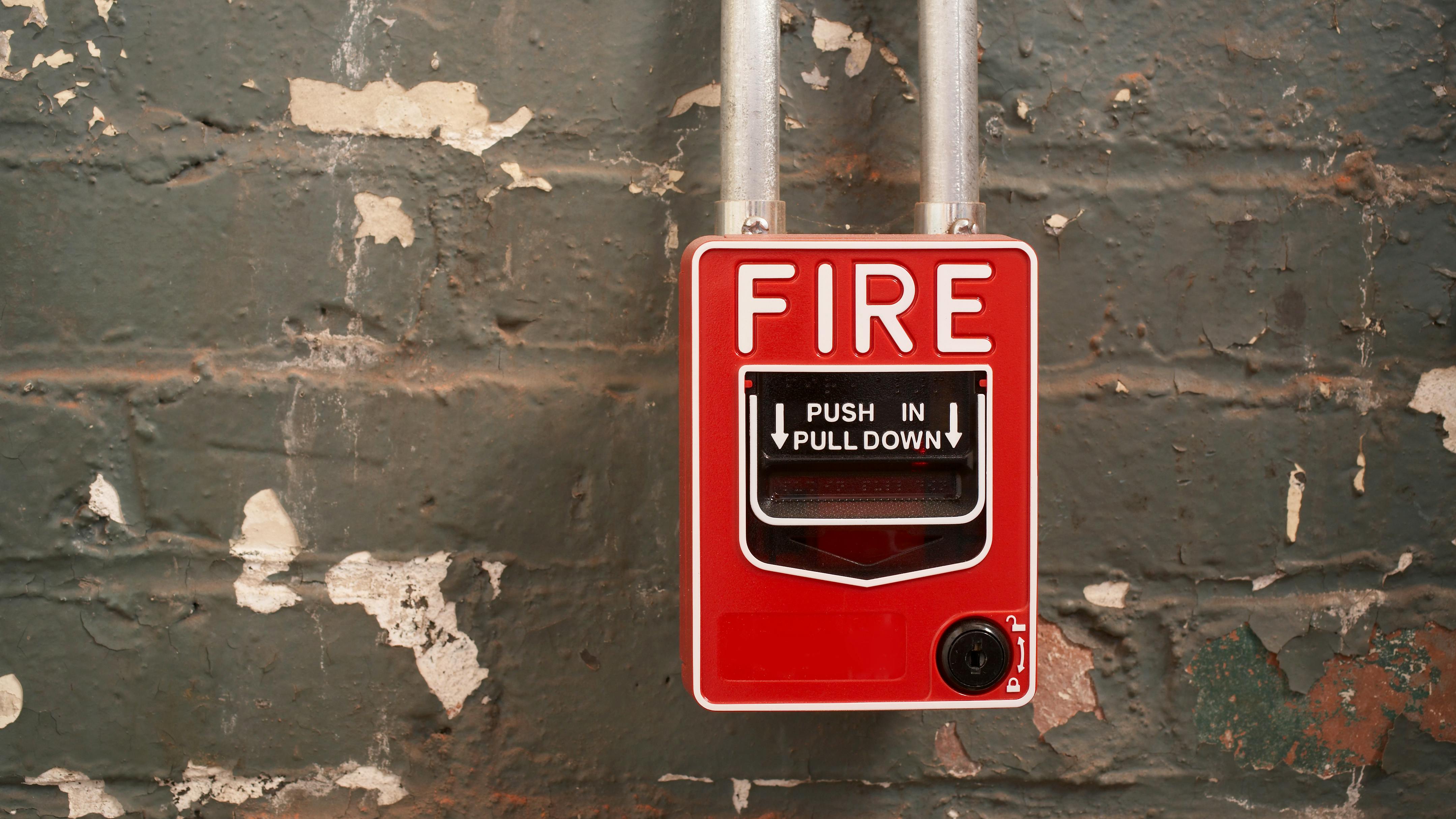

Q1: Fire alarm circuit cables and conductors installed exposed on the surface of ceilings and sidewalls shall be supported by _____, hangers, or similar fittings designed and installed so as not to damage the cable.

Q1: d) any of these
According to Sec. 760.24(A), "Such cables shall be supported by hardware, including straps, staples, hangers, listed cable ties identified for securement and support, or similar fittings designed and installed so as not to damage the cable."
