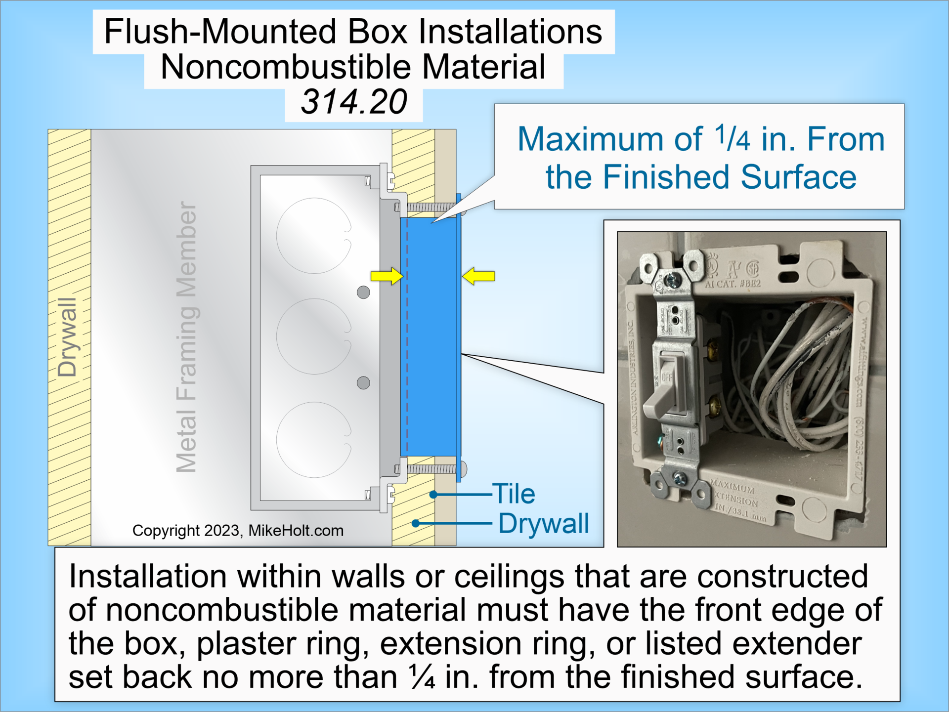

Fig. 1. The NEC requirements for flush-mounted box installations can be found in Sec. 314.20.

Q. What are the NEC requirements related to flush-mounted boxes?
A. The NEC requirements related to flush-mounted boxes can be found in Sec. 314.20.
Noncombustible Walls and Ceilings. Installation within walls or ceilings finished with a noncombustible material must have the front edge of the box, plaster ring, extension ring, or listed extender set back no more than ¼ in. from the finished surface (Fig. 1).
Combustible Walls and Ceilings. Installation within walls or ceilings constructed of wood or other combustible material must have the front edge of the box, plaster ring, extension ring, or listed extender extend to, or project out from, the finished surface.
Author’s Comment:
  • Plaster rings and extension rings are available in a variety of depths to meet the above requirements.
  • Final finished surfaces (such as backsplashes and tile) may need the use of listed extenders to meet the requirements of this section.
