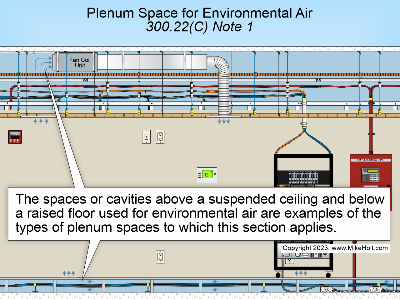

(C) Plenum Spaces for Environmental Air. This section applies only to the space above a suspended ceiling or below a raised floor used for environmental air. It does not apply to habitable rooms or areas of buildings, the prime purpose of which is not air handling.
Note 1: The spaces or cavities above a suspended ceiling and below a raised floor used for environmental air are examples of the type of plenum spaces to which this section applies. (Figure)
