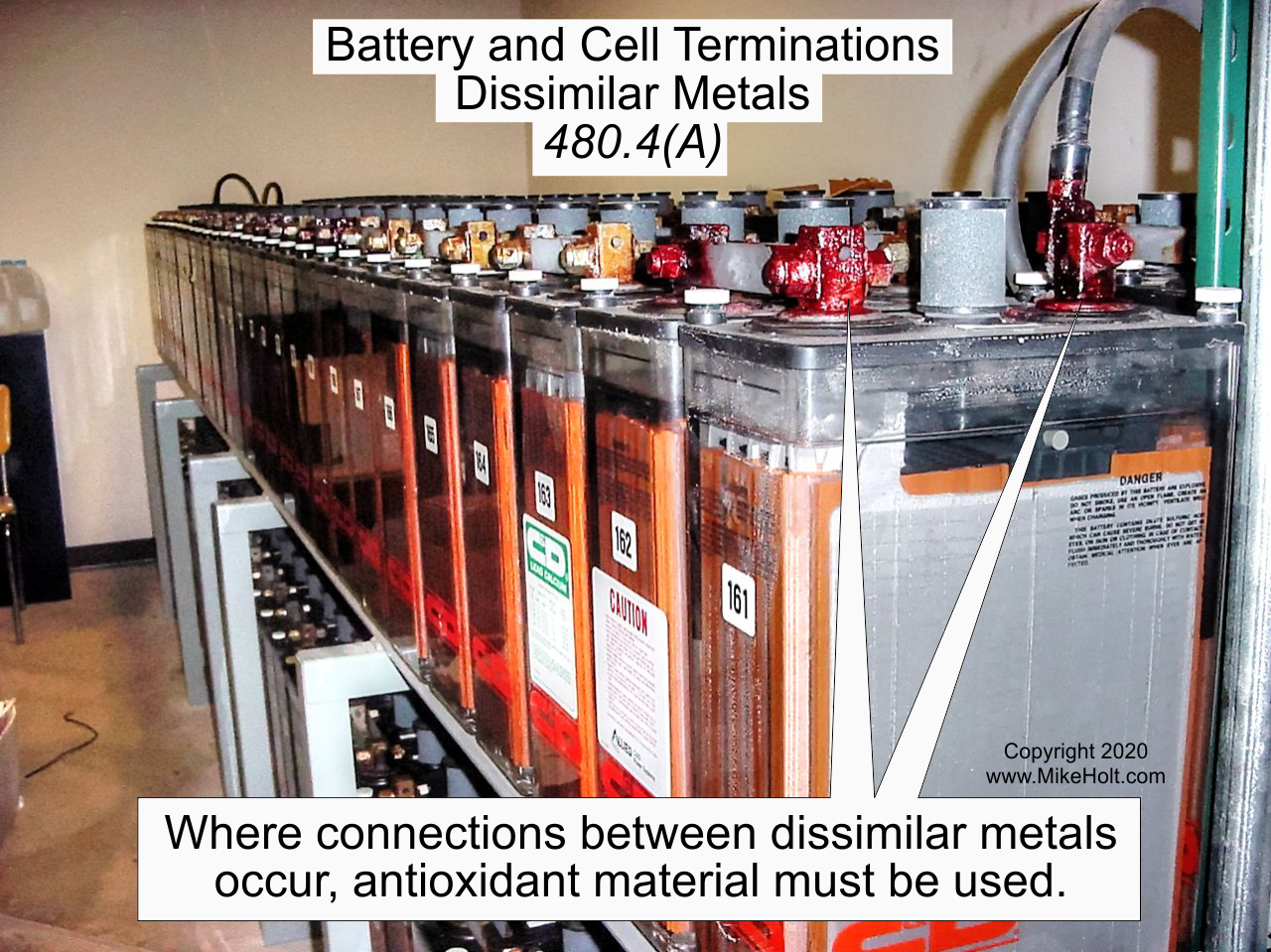

Where connections between dissimilar metals occur, antioxidant material must be used.

Q. Does the NEC require an antioxidant for battery and cell terminations?
See answer below.
A. Where connections between dissimilar metals occur, antioxidant material must be used where recommended by the battery manufacturer (Figure).
