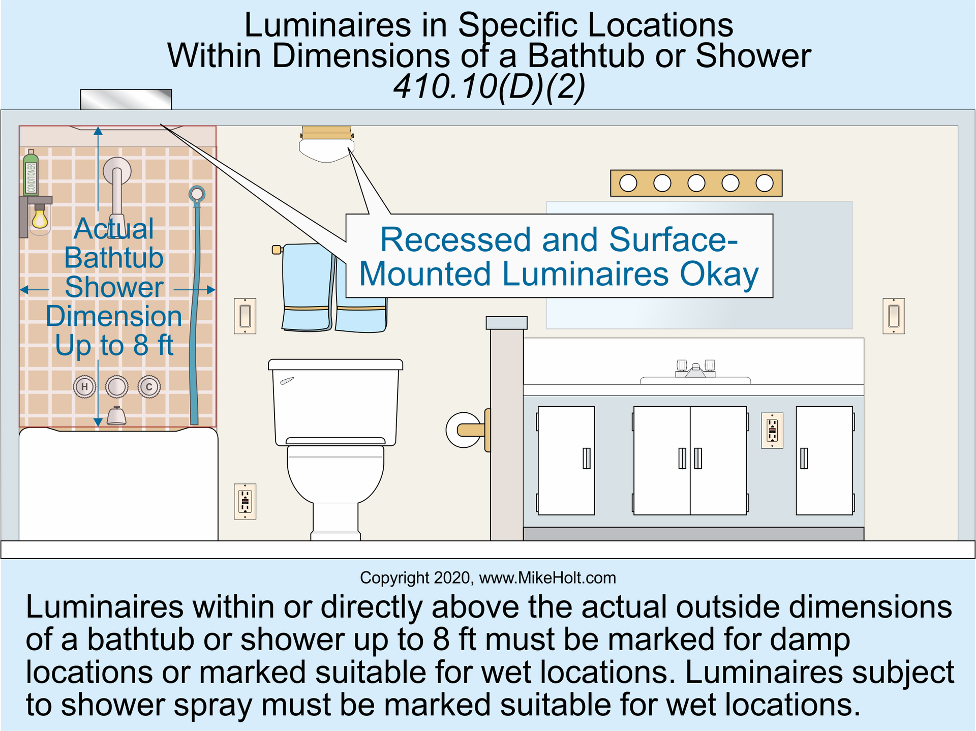

Q. A luminaire installed in a bathtub or shower area must meet what NEC requirements?
A. A luminaire installed in a bathtub or shower area must meet all of the following requirements [Sec. 410.10(D)]:
(1)  No part of chain-, cable-, or cord-suspended luminaires, track luminaires, or ceiling paddle fans can be located within 3 ft horizontally and 8 ft vertically from the top of the bathtub rim or shower stall threshold (Fig. 1).
(2)  Luminaires located within the actual outside dimensions of a bathtub or shower to a height of 8 ft from the top of the bathtub rim or shower threshold must be marked for damp locations or marked suitable for wet locations. Where subject to shower spray, the luminaires must be marked suitable for wet locations (Fig. 2).
Author’s comment: The previous Code language required the luminaire to be marked “wet locations where subject to shower spray.” There is no such marking on any luminaire.
