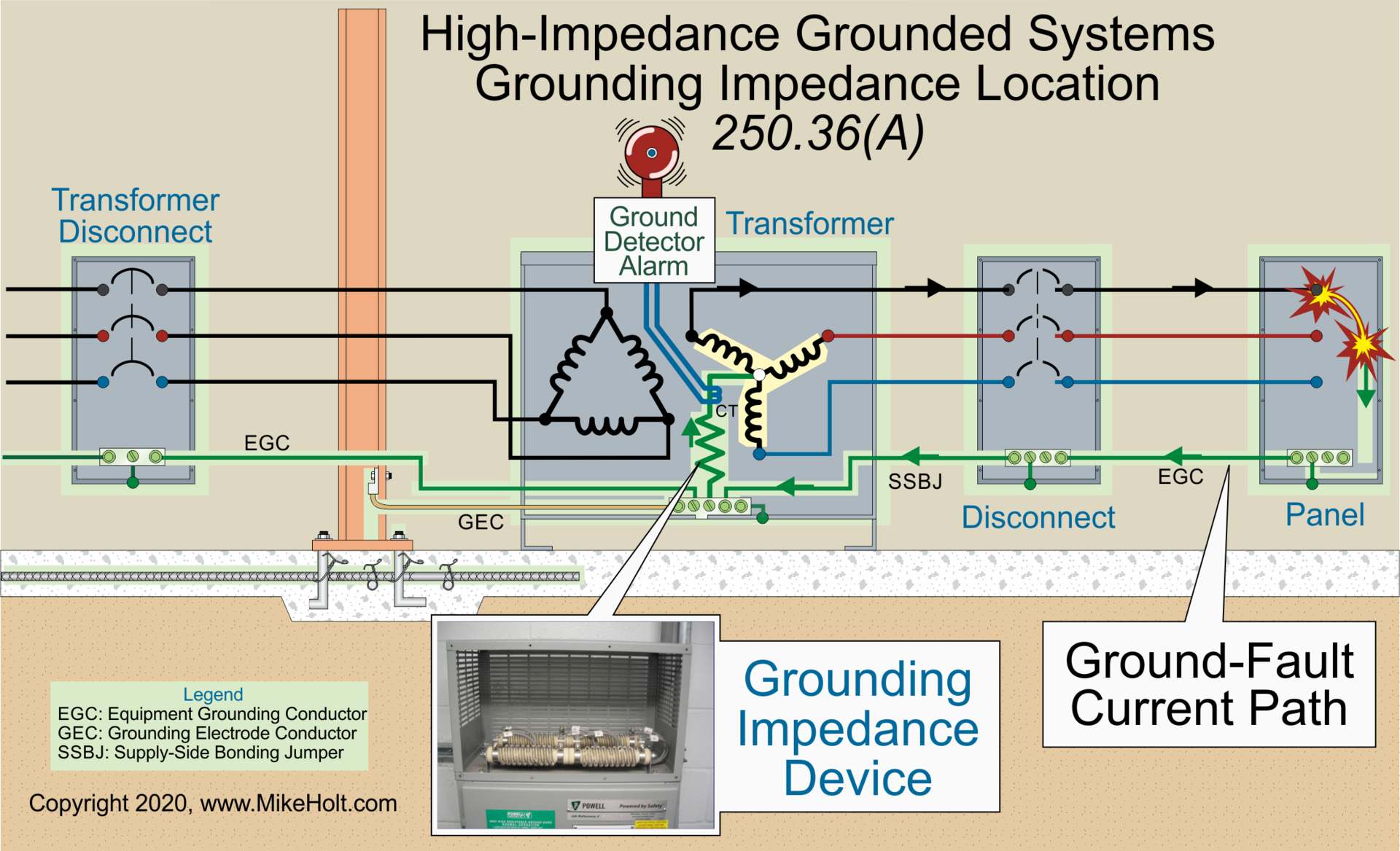

Fig. 1. High-impedance grounded systems have a resistor installed between the neutral point of the separately derived system and the equipment grounding conductor.

Q. What NEC conditions allow for the installation of high-impedance grounded systems?
A. To limit ground-fault current to a low value, a high-impedance grounded system is permitted to be installed on 3-phase systems of 480V up to 1,000V where all the following conditions are met [Sec. 250.36]:
(1) Conditions of maintenance and supervision ensure that only qualified persons service the installation.
(2) Ground detectors are installed on the system.
(3) Only line-to-line loads are served.
Informational Note: According to Annex O of NFPA 70E, Standard for Electrical Safety in the Workplace, high-impedance grounding is an effective tool to reduce arc flash hazards.
Author’s Comments:
  • High-resistance grounding will insert an impedance in the ground return path and will typically limit the fault current to 10A or less, leaving insufficient fault energy and thereby reducing the arc-flash hazard level. High-resistance grounding will not affect arc-flash energy for line-to-line faults [Annex O NFPA 70E].
  • High-impedance grounded systems are generally referred to as “High-Resistance Grounded Systems” in the industry. These systems are generally used where sudden interruption of power will create increased hazards and where a reduction of incident energy is needed for worker safety.
(A) Grounding Impedance Location. A grounding impedance is typically a resistor installed between the neutral point of the separately derived system and the grounding electrode conductor (Fig. 1 below).
