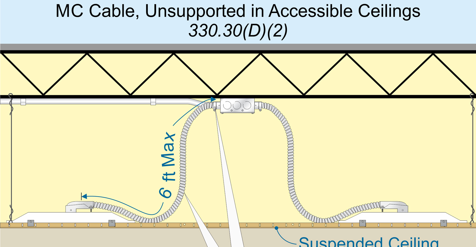

Type MC cable can be unsupported and unsecured where [330.30(D)]:
 (1) Fished through concealed spaces in a finished building and support is impractical.
 (2) Not more than 6 ft long from the last point of cable support to the point of connection to a luminaire or electrical equipment within an accessible ceiling. For the purposes of this section, Type MC cable fittings are permitted as a means of cable support (Figure). 
