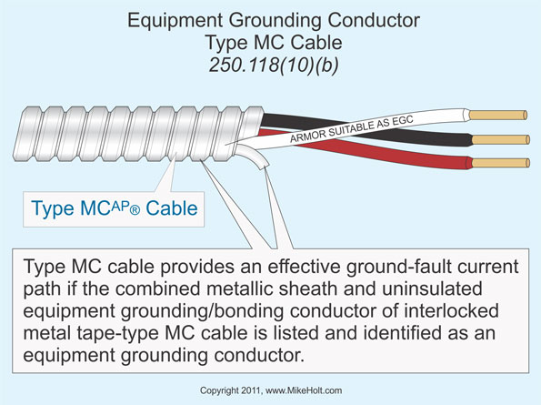

10) Type MC cable that provides an effective ground fault current path in accordance with one or more of the following:
a. It contains an insulated or uninsulated equipment grounding conductor in compliance with 250.118(1).
b. The combined metallic sheath and uninsulated equipment grounding/bonding conductor of interlocked metal tape-type MC cable that’s listed and identified as an equipment grounding conductor, as shown in the Figure. Note: Once the bare aluminum grounding/bonding conductor exits the cable, it can be cut off because it no longer serves any purpose. The effective ground fault current path must be maintained by the use of fittings specifically listed for Type MCAP cable [330.40]. See 300.12, 300.15, and 330.100.
c. The metallic sheath or the combined metallic sheath and equipment grounding conductors of the smooth or corrugated tube-type MC cable that’s listed and identified as an equipment grounding conductor.
