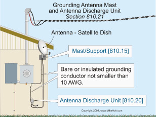

Q. What are the grounding requirements for a satellite dish?
A. Article 810 includes the requirements for various antennas, including satellite dishes [810.1]. The antenna mast [810.15] and antenna discharge unit [810.20(C)] must be grounded as follows, according to 810.21 and shown in Fig. 1.
Grounding the lead-in antenna cables and the mast helps prevent voltage surges caused by static discharge or nearby lightning strikes from reaching the center conductor of the lead-in coaxial cable. Because the satellite sits outdoors, wind creates a static charge on the antenna as well as on the cable attached to it. This charge can build up on both the antenna and the cable, until it jumps across an air space — often passing through the electronics inside the low noise block down converter feed horn (LNBF) or receiver. Grounding the coaxial cable and dish to the building grounding electrode system helps to dissipate this static charge.
Nothing can prevent damage from a direct lightning strike, but grounding with proper surge protection can help reduce damage to satellite and other equipment from nearby lightning strikes. Here are some key items to keep in mind.
  • Material. The grounding conductor to the electrode [810.21(F)] must be copper or other corrosion-resistant conductive material, stranded or solid [810.21(A)].
  • Insulation. The grounding conductor isn’t required to be insulated [810.21(B)].
  • Supports. The grounding conductor must be securely fastened in place [810.21(C)].
  • Mechanical protection. The grounding conductor must be mechanically protected where subject to physical damage and where run in a metal raceway. Both ends of the raceway must be bonded to the grounding conductor [810.21(D)].
Installing the grounding conductor in PVC conduit is a better practice when the AHJ judges that physical protection is not required. The grounding conductor must be run in as straight a line as practicable [810.21(E)]. Lightning doesn’t like to travel around corners or through loops, which is why the grounding conductor should be run as straight as practicable.
The grounding conductor for the antenna mast and antenna discharge unit must terminate to the intersystem bonding termination, if there is one [Art. 100 and Sec. 250.94]. Bonding all systems to the intersystem bonding termination helps reduce induced potential (voltage) between the power and radio and TV systems during lightning events.
In buildings or structures without intersystem bonding termination, the grounding conductor for the antenna mast and antenna discharge unit terminates to the nearest accessible:
  • Building or structure grounding electrode system [250.50].
  • Interior metal water piping system, within 5 ft from its point of entrance [250.52(A)(1)].
  • Accessible means external to the building, as covered in 250.94.
  • Metallic service raceway.
  • Service equipment enclosure.
  • Grounding electrode conductor or the grounding electrode conductor metal enclosure.
In buildings or structures without a grounding means, the grounding conductor for the antenna mast and antenna discharge unit terminates to:
  • Any individual electrodes described in 250.52.
  • Structural steel grounded in accordance with 250.52(A)(2).
The grounding conductor can be run either inside or outside the building [810.21(G)], and it must not be smaller than 10 AWG copper or 17 AWG copper-clad steel or bronze [810.21(H)]. Copper-clad steel or bronze wire (17 AWG) is often molded into the jacket of the coaxial cable to simplify the grounding of the satellite dish by eliminating the need to run a separate grounding conductor to the dish [810.21(F)(2)].
If a ground rod is installed to serve as the ground for the radio and TV equipment, it must be connected to the building’s power grounding electrode system with a minimum 6 AWG conductor [810.21(J)].
Termination of the grounding conductor must be by exothermic welding, listed lug, listed pressure connector, or listed clamp. Grounding fittings that are concrete-encased or buried in the earth must be listed for direct burial [250.70] and marked “DB” [810.21(K)].
