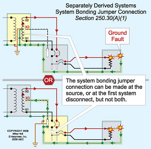

Q. Can I connect the neutral conductor to the equipment-grounding terminal at both the transformer and the first disconnect?
A. No. The NEC requires the neutral conductor of a transformer that meets the definition of a separately derived system to be connected to the equipment-grounding conductor at the transformer or the disconnecting means or overcurrent device on the secondary — but not at both locations [250.30(A)(3)]. The connection of the neutral conductor to the equipment-grounding conductor is called a system bonding jumper, and it provides a low-impedance fault current path to the power supply to facilitate the clearing of a ground fault by opening the circuit overcurrent device. For more information, see 250.2, 250.4(A)(5), 250.28, and 250.30(A)(1), as shown in the Figure.
Caution: Dangerous objectionable neutral current will flow on conductive metal parts of electrical equipment as well as metal piping and structural steel, in violation of 250.6(A), if more than one system bonding jumper is installed. Objectionable neutral current on metal parts can cause electric shock, fires, and improper operation of electronic equipment and overcurrent devices such as GFPs, GFCIs, and AFCIs.
