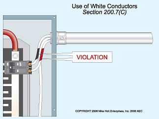

Q. What are the NEC requirements on the use of the white wire for the ungrounded conductor?
A. A conductor with white insulation can only be used for the ungrounded conductor as permitted as follows [200.7(C)]:
Cable assembly
The white conductor within a cable can be used for the ungrounded conductor if permanently reidentified at each location where the conductor is visible to indicate its use as an ungrounded conductor. Identification must encircle the insulation and must be a color other than white, gray, or green.
Switches
The white conductor within a cable can be used to supply power to single-pole, 3-way, or 4-way switch loops if permanently reidentified at each location where the conductor is visible to indicate its use as an ungrounded conductor.
Flexible cord
The white conductor within a flexible cord can be used for the ungrounded conductor for connecting an appliance or equipment as permitted by 400.7.
FPN: Use care when working on existing systems, because a gray insulated conductor may have been used in the past as an ungrounded conductor.
The NEC doesn't permit the use of white or gray conductor insulation for ungrounded conductors in a raceway, even if the conductors are permanently reidentified (Figure).
