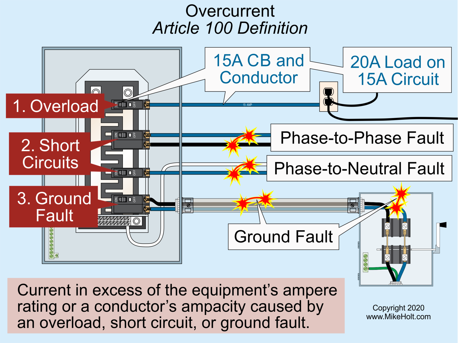

Fig. 1. Overcurrent is defined in Art. 100 of the National Electrical Code (NEC).

Article 240 provides the requirements for overcurrent protection and selecting/installing overcurrent protective devices (OCPDs) — typically circuit breakers or fuses. Overcurrent exists when the current exceeds the ampere rating of equipment or the ampacity of a conductor due to an overload, short circuit, or ground fault [Art. 100] (Fig. 1).
Overloads, shorts, and faults
These terms are not interchangeable:
  • Overload. A condition where equipment or conductors carry current exceeding their current rating [Art. 100]. A fault, such as a short circuit or ground fault, is not an overload. An example of an overload is plugging two 12.50A (1,500W) hairdryers into a 20A branch circuit.
  • Short circuit. The unintentional electrical connection between any two normally current-carrying conductors of an electric circuit, either line-to-line or line-to-neutral.
  • Ground fault. An unintentional, electrically conducting connection between a phase conductor of a circuit and the normally non-current-carrying conductors, metal enclosures, metal raceways, metal equipment, or the earth [Art. 100]. When a ground fault occurs, dangerous voltages are present on metal parts until the circuit OCPD opens and clears the fault.
