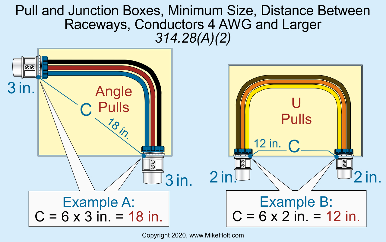

Fig. 1. The distance between raceway entries enclosing the same conductor must be at least 6 times the trade size of the largest raceway.

  • Angle pulls. These occur when raceways containing conductors enter a wall and leave through one that’s 90º from the entry wall. The distance from the raceway entry to the opposite wall must be at least six times the trade size of the largest raceway, plus the sum of the trade sizes of the remaining raceways on the same wall and row.
  • U pulls. A raceway containing conductors that enters and leaves from the same wall is a U pull. The distance from where the raceways enter to the opposite wall must be at least six times the trade size of the largest raceway, plus the sum of the trade sizes of the remaining raceways on the same wall and row.
  • Splices. When conductors are spliced, the distance from where the raceways enter to the opposite wall must be at least six times the trade size of the largest raceway, plus the sum of the trade sizes of the remaining raceways on the same wall and row.
  • Rows. Where there’s more than one row of raceway entries on the same wall, each row is calculated individually, and the row with the largest distance must be used.
  • Distance between raceway entries. The distance between raceway entries enclosing the same conductor must be at least six times the trade size of the largest raceway, measured from the raceways’ opening nearest edge to the nearest edge (Fig. 1).

What’s the minimum distance between the two trade size 3 raceways containing the same conductors?
Solution: 6 × 3 in. = 18 in.
Answer: (a) 18 in. [Sec. 314.28]

If the two trade size 3 raceways contain the same conductors, what’s the minimum distance between these raceways?
Answer: (a) 18 in. [Sec. 314.28(A)(2)]
