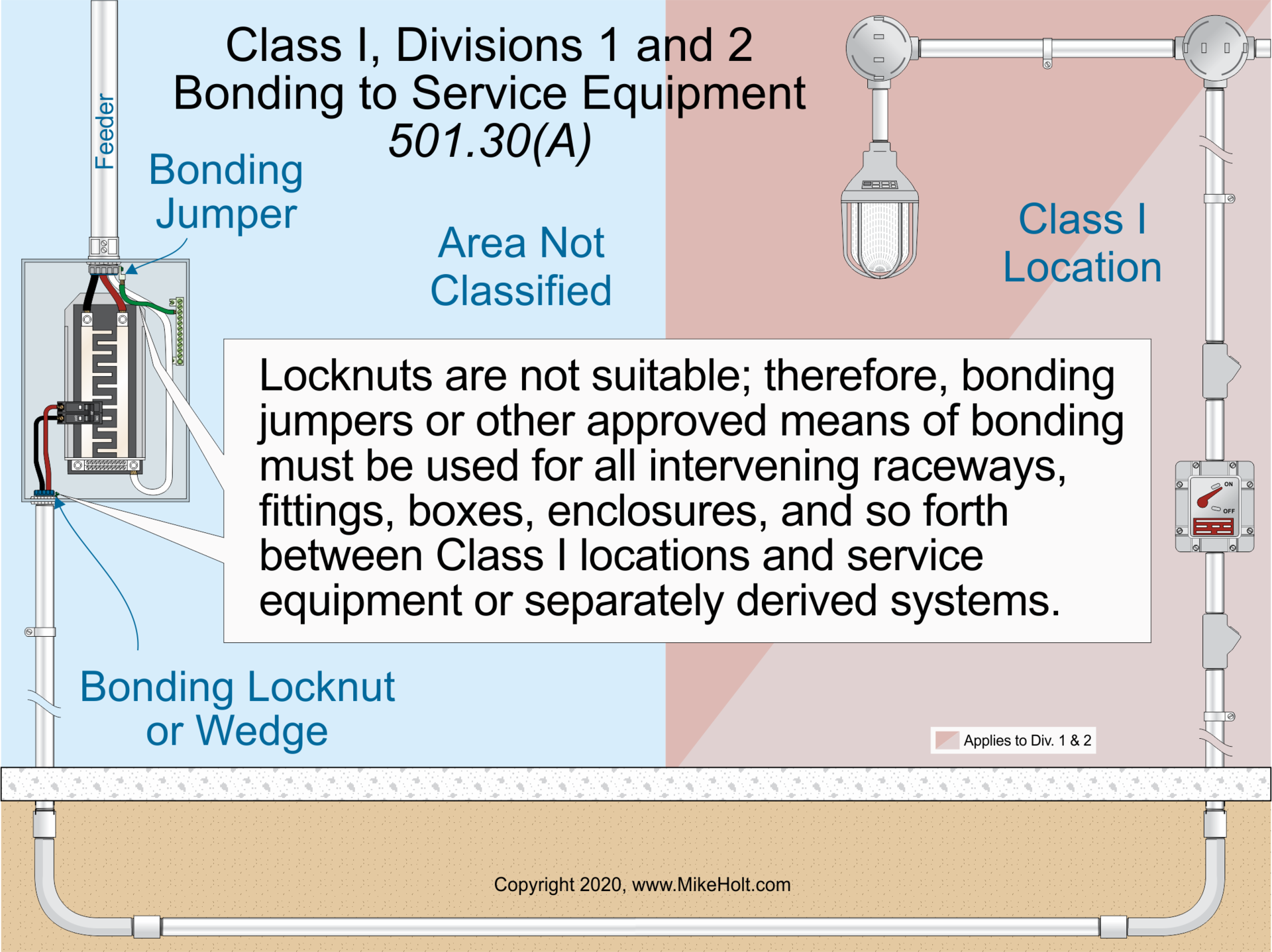

Fig. 1. Because of the explosive conditions associated with electrical installations in hazardous locations, electrical continuity of metal parts of equipment and raceways must be ensured.

Class I, II, and III locations
Bonding in hazardous classified locations is intended to provide a low impedance path free from accidental arcing due to loose connections. The special bonding requirements are the same for all three Classes of location. Here, we use Art. 501 as the reference.
Because of the explosive conditions associated with electrical installations in hazardous locations [Sec. 500.5], electrical continuity of metal parts of equipment and raceways must be ensured regardless of the circuit voltage [Sec. 501.30 (see also Sec. 502.30 and Sec. 503.30)].
Locknuts are unsuitable for bonding in hazardous locations; therefore, bonding jumpers or other approved means of bonding must be used for all raceways, fittings, boxes, enclosures, etc. between Class I locations and service equipment or separately derived systems [Sec. 501.30(A)] (Fig. 1).
Regardless of the circuit voltage, electrical continuity of the metal parts of equipment and raceways in hazardous locations must be ensured by the use of bondingtype locknuts, wedges, or bushings with bonding jumpers [Sec. 250.92(B)(4)] whether or not equipment grounding conductors of the wire type are installed in the raceway [Sec. 250.100]. Locknuts alone are not enough to serve this purpose.
A separate equipment grounding conductor (EGC) is not required if a metal raceway is used for equipment grounding. Threaded couplings and hubs made up wrench tight provide a suitable lowimpedance fault current path [Sec. 250.92(B)(2)].
Where flexible metal conduit or liquidtight flexible metal conduit is installed as permitted by Sec. 501.10(B)(2), an equipment bonding jumper of the wire type must be installed per Sec. 250.102 [Sec. 501.30(B)].
Size bonding jumpers per Table 250.122, based on the rating of the overcurrent protective device [Sec. 250.102(D)]. Where installed outside a raceway, the bonding jumpers cannot exceed 6 ft long, and they must be routed with the raceway [Sec. 250.102(E)(2)].
