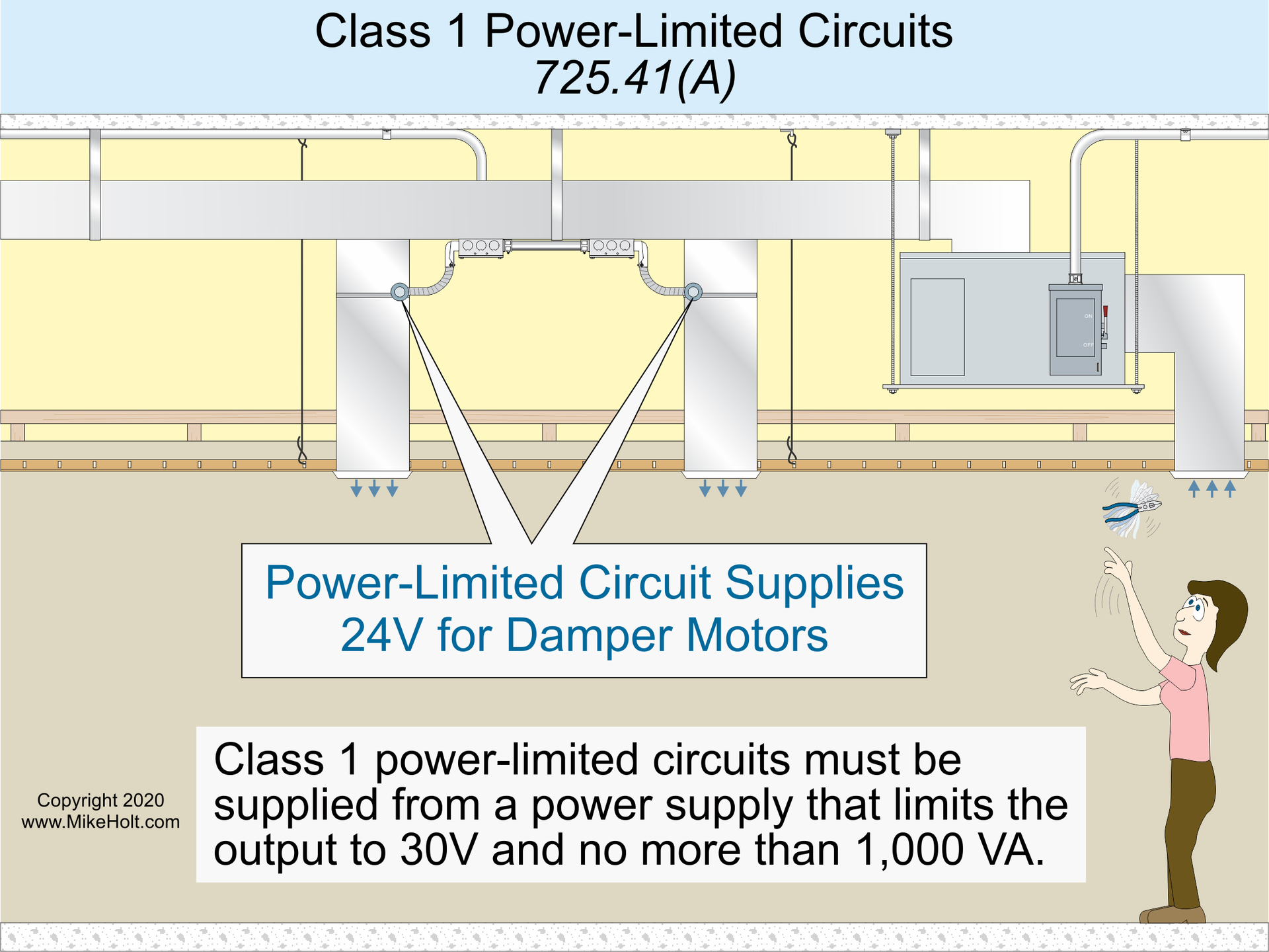

Article 725 provides the requirements for Class 1 circuits in Part II. A Class 1 circuit is that portion of the wiring between the overcurrent protective device (OCPD) of a Class 1 power supply and the load [Art. 100 definition]. There are two types:
Class 1 power-limited circuits, which must be supplied from a power supply that limits the output to 30V with no more than 1,000VA [Sec. 725.41(A)] (Fig. 1).
  • Class 1 remote-control and signaling circuits, which must operate at not more than 600V without any power limitation [Sec. 725.41(B)] (Fig. 2).
  • Class 1 power-limited circuits are somewhat uncommon. They are used when the voltage must be under 30V (safe from electric shock in dry locations) and the power demands exceed the 100VA energy limitations of Class 2 circuits, such as for motorized loads like remote-controlled window blinds [Chapter 9, Table 11(A)].
