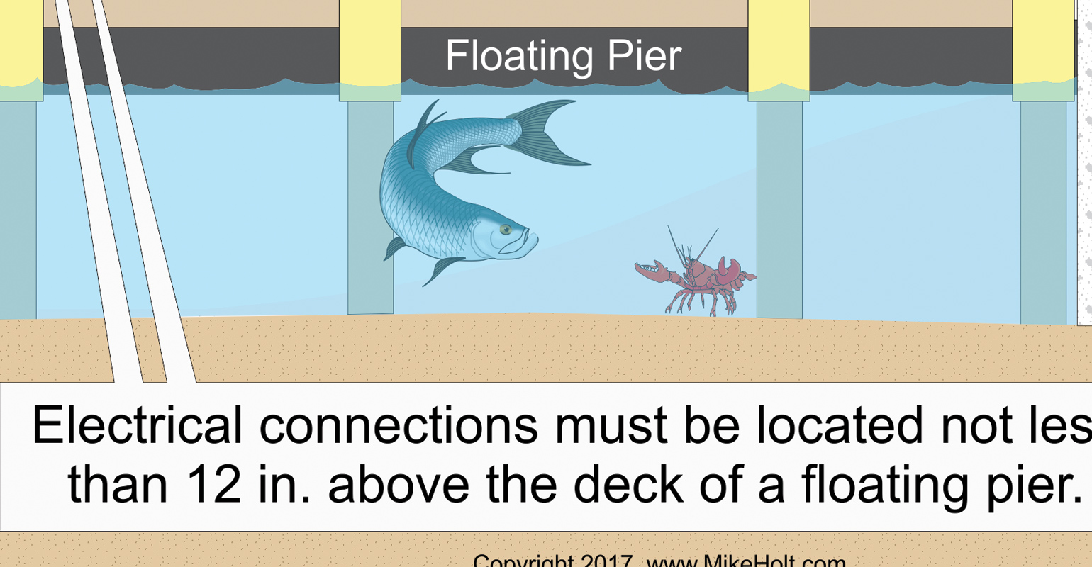

Electrical connections must be at least 12 in. above the deck of a floating pier (Fig. 1). If the conductor splices are contained within approved junction boxes using sealed wire connector systems listed and identified for submersion, they can be above the waterline but below the electrical datum plane for floating piers [555.9] (Fig. 2).
