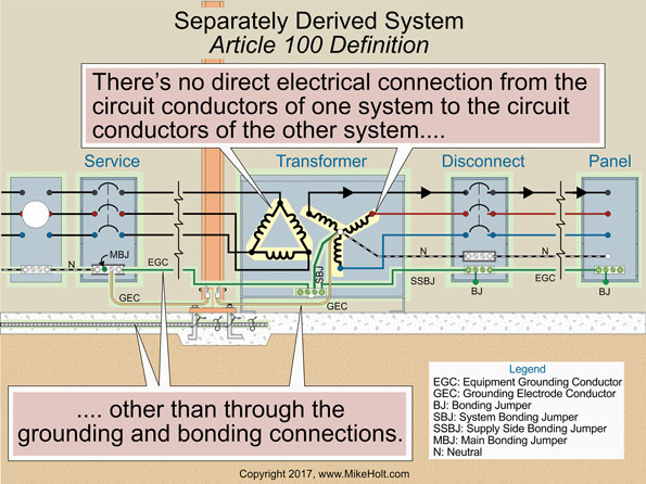

A transformer transfers electrical energy from one system to another by induction. Except for grounding and bonding connections, there’s no physical connection between the two systems. For this reason, the NEC refers to transformers as “separately derived systems,” as shown in Fig. 1.

You must install a system bonding jumper at the same location where the grounding electrode conductor (GEC) terminates to the neutral point of a transformer. Size it per Sec. 250.102(C), based on the area of the secondary conductors [250.30(A)(1) and 250.28(D)(1)].
A GEC must connect the neutral point of a separately derived system to a grounding electrode of a type identified in Sec. 250.30(A)(4). Size the GEC per 250.66 based on the area of the ungrounded secondary conductor [250.30(A)(5)].
Can you be error-free? If you think of transformers as being the electricity that goes through them, it’s easier to apply transformer theory. Except for autotransformers, all transformers consist of two sets of interacting coils. The turns ratio of the primary set to the secondary set determines the degree to which the voltage is transformed (raised or lowered).
To keep from making grounding and bonding errors, remember there’s a difference between grounding and bonding. Grounding is the connection to the earth. It’s accomplished with the grounding electrode and the GEC. This connection to earth won’t provide an effective ground fault return path. That’s the role of proper bonding.
With transformers, a vital link in the bonding path is the system bonding jumper. It must be installed on the secondary of the transformer, either in the transformer or in the panel. The system bonding jumper completes the bonding path back to the source (the transformer secondary) to provide an effective fault current path.
