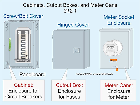

Article 312
So now your raceway conforms to its Article (in the case, Art. 344), and your conductors conform to Art. 310. But to what are you connecting the raceway? A cabinet? A cutout box?
Fig. 1. Article 312 covers the installation and construction specifications for cabinets, cutout boxes, and meter socket enclosures.
Article 312 covers the installation and construction specifications for cabinets, cutout boxes, and meter socket enclosures (Fig. 1). These aren’t the only types of “connection points” for a raceway, but they are commonly used (we’ll cover the other types in a moment).
Just as the conditions of use have an effect on the ampacity of a conductor, so do they have an effect on the selection and application of cabinets, cutout boxes, and meter socket enclosures. For example, you can’t use just any enclosure in a wet location or in a hazardous location. The conditions of use impose special requirements for these situations.
Certain requirements apply to all enclosures, regardless of the use. For example, you must cover any openings, protect conductors from abrasion, and allow sufficient bending room for conductors.
Notice that Art. 408 covers switchboards and panelboards, with primary emphasis on the interior, or “guts,” while Art. 312 covers the cabinet that would be used to enclose a panelboard. Therefore, you’ll find that some important considerations, such as wire-bending space at terminals of panelboards, are included in Art. 312.
