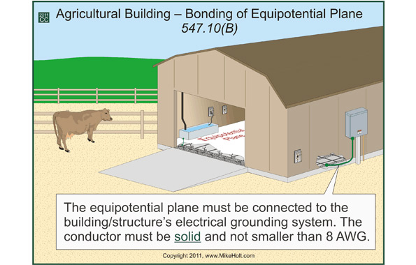

Equipotential plane — The equipotential bonding described in 547.10 is similar to the requirements for bonding swimming pools in 680.26. Both require an 8 AWG or larger copper conductor, but only 680.26 required this conductor to be solid in the previous Code. Section 547.10 of the 2011 NEC now also requires that the bonding conductor be an 8 AWG or larger solid copper conductor (Fig. 1).
The special bonding requirements of Art. 547 exist because of the sensitivity of livestock to stray voltage/current, especially in wet or damp concrete animal confinement areas. Typically, the voltage difference between metal parts and the earth is too low to present a shock hazard. However, livestock might detect the voltage difference if they touch metal parts. Although potential differences may not be life threatening to the livestock, it’s been reported that as little as 0.50V RMS can affect milk production.
Methods to establish equipotential planes are described in the American Society of Agricultural and Biological Engineers Standard EP473, “Equipotential Planes in Animal Containment Areas.” This standard provides the recommendation of a voltage gradient ramp at the entrances of agricultural buildings.
