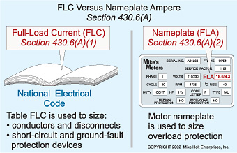

General requirements. For general motor applications, current ratings shall be based on 430.6(A)(1) and (2). You should also be familiar with the difference between full load currents and nameplate current ratings of motors.
Full load currents [430.6(A)(1)]. Use the motor full load current (FLC) rating (Tables 430.147, 430.148, or 430.150) when determining conductor ampacity (430.22), the branch-circuit short-circuit and ground-fault protection device (430.52 and 430.62), and the ampere rating of switches (430.110). Don't use the current rating on the motor nameplate for this purpose (Fig. 1).
It's also important to know how to properly connect motor terminals and where to locate motors within the system.
Motor nameplate current rating [430.6(A)(2)]. Use motor nameplate current ratings when selecting devices for protecting motors and their control apparatus and branch-circuit conductors against excessive heat caused by motor overloads and failure to start (430.31).
