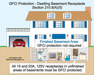

Basement. You must install a receptacle in each unfinished portion of a dwelling unit basement [210.52(G)]. If this space isn't intended as a habitable room (and is limited to storage and work areas), provide GFCI protection for all receptacles (Fig. 1). Two exceptions exist:
  1. Receptacles that aren't readily accessible.
  2. A receptacle on a dedicated branch circuit identified for a specific cord-and-plug connected appliance.
