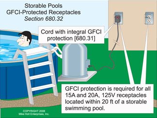

For storable pools, cord-connected pumps must be double insulated and have a means to bond the internal metal parts to an equipment grounding conductor run with conductors in the cord. The attachment plug must have integral GFCI protection [680.31].
GFCI protection is required for all receptacles that supply the electrical equipment used with storable pools [680.32] ( Fig. 1 ). Receptacles must be located at least 6 ft from the inside walls of a storable pool. This distance is measured using the shortest path a cord could follow without passing through a wall, doorway, or window [680.34].
