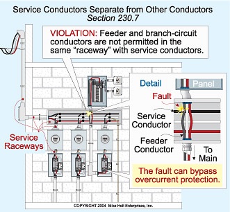

Don't install service conductors in the same raceway (or cable) as feeder or branch-circuit conductors [230.7] (Fig. 2). Otherwise, overcurrent protection for the feeder or branch-circuit conductors could be bypassed if a fault occurred between the service and non-service conductors. However, this rule doesn't prohibit the mixing of service, feeder, and branch-circuit conductors in the same “service equipment enclosure.”
This requirement may be the root of the misconception that you can't install “line” and “load” conductors in the same raceway. It's true. You can't install service conductors in a raceway with feeder or branch-circuit conductors, but you can install line and load conductors for feeders and branch circuits in the same raceway or enclosure.
