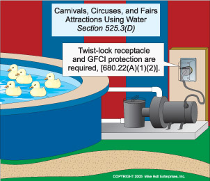

  • Attractions that utilize water
    Anyone installing such things as swimming pools, fountains, dunk tanks, bumper boats, and duck ponds needs to refer to Article 680 [525.3(D)].
If you use electric motors to circulate water in a tank that guests might touch, Article 680 applies. A key provision: 680.22(A)(1) permits a GFCI-protected single locking-type receptacle for a water-pump motor between 5 feet and 10 feet from the water (Fig. 1 on page 58).
