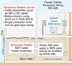

  • Feeders. Open conductors are not allowed for temporary installations. Feeders are permitted in cable assemblies, including Type NM and Type NMC, hard usage cords, and extra-hard usage cords [590.4(B)], as shown in Fig. 1.
  • Branch circuits. The wiring methods allowed for feeders are also allowed for branch circuits, including Type NM and NMC cable exposed or concealed in any dwelling, building, or structure without any height limitation [590.4(C)], as shown in Fig. 2.
